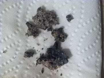

[Hearth.com] Ash Clinkers? Have you ever had this happen? I get them every cleanout. They are never adhered to anything like mentioned in the other thread, just seam to be floating around in the ash. I took one out and washed it in water and took a picture of it. I thought at first it might be the leftovers from cheap walmart firestarters but tested that theory and they remain.

All wood has silaca in it some more than others. What you are seeing is fused silica partical (Glass) Local potter has a wood fired kiln when he fires that ash is carried over the pots when he gets the temp up the ash melts and forms the glaze for the pots. Same thing in your stove. Formation has to do with temp air flow and wood.
I've been getting lots of those thingys lately too. I think it's from the mineral uptake that the Elm trees are especially known for. I've been burning pretty much straight Elm w/some Mulberry. What's really cool is some time I see some green colored globs or wispy flakes laying near the bigger clunks/clinks. Makes me think of oxidized copper minerals??? I've read several times that Elms are notorious for uptake of silicates???;em
