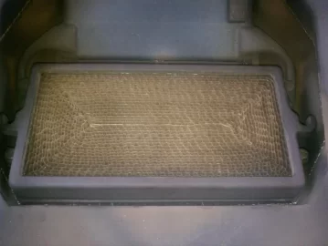

You guys sure know how to cheer someone up, much appreciated, I guess there a little tougher than I thought. Took my cat out today anyway and inspected it, seems fine, looks like it did before, no residue caked on it or anything, but I cleaned it anyway just in case. My question is I have never removed the shipping bolts that woodstock talks about. Please see the pic below and tell me if the right bolts are missing, if so I guess the cat just sits in place without anything holding it, is this correct?

I asked Applied Ceramics a couple years ago and they said air cans were ok, air compessors not ok. Probably not smart to use it on a hot cat since the air comes out cold like you said. I like to use the air can on my Keystones, much easier than removing the access plate and removing the cat, I save that for the end of the season.
