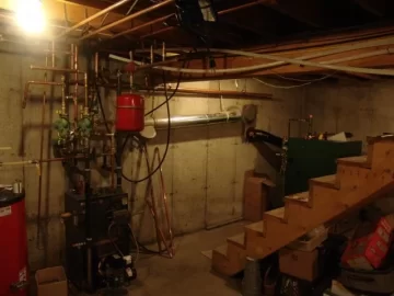

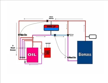

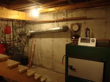

Is this true,
My plummer said when the biomass is charging the tank it will keep circulating until the water returning is hot and it will satisfy the wood boiler and shut it down.
My circulator will be connected to the RK-2001U controller. Should I use an aquastat also in conjunction with the controller? If so where should it be located and how should it be connected?
Here are some installation pictures , radiant zone being added too.
Rob
Rob
