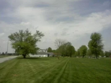

I now have 2 acres Wooooot Woooot one acre was a rail road that went through the back yard for 125 years. After 4 years working on it the grass is starting to fill in.

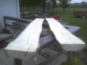

Will mini mill them into beams and the extra will become the T's.

I will run off center and will become 1/4 sawn when done. 4x6 length now is 9 ft six inchs. Measure the gf reach and need 6ft 1 inch tall lines.

Smokin it looks good but your wood piles in the back need more wOOd! :vampire:

4 cords there another 3-4 cords piled that will get split this coming weekend and still need 3 more. Yes very tough winter and spring here. Oh and fighting the eletricman is the man focus.

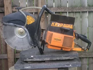

Partner K650 with 12" diamond wheel works for me.Its 17 yrs old now,model has been redesigned & upgraded a few times since them.They've (now under Husqvarna group) made a K1250 model with 120cc/7.8HP powerhead capable of handling 16" wheels for years now,too much for me to carry on a regular basis (about 32lbs) not to mention $$$$

My other baby lol. 17yrs old now,has cut 4" & 5" thick granite,limestone & concrete w/heavy gauge rebar all day long.Hooked up to garden hose,blade stays cooler & no dust clouds.I bought this new,did 2 side jobs for cash after work & 1 weekend,paid it off. :coolgrin:
Partner of Sweden invented the gas cut-off saw,originally designed for rescue work,back in the late 1950's.Now part of the Husqvarna Construction Group,they have a 14" gas saw w/ off-set 'ring' blade that will cut 10" thick,instead of normal 5" like conventional saws.

That is a HOSS!

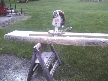

Mini Mill with a 192t cutting out beams. 4 inch think ash. Hated the mini mill as a log first cut but as a re-saw too its pretty sweet, and the narrow kerf of the 192t its a nice little set-up.

Just like Will Malloff in that 'bible'. :coolsmile: Gonna try that with me little Echo before long.It has .043 low profile chain also.Be great on stuff thicker than 2 3/8".Thinner stuff I'll keep using the wormdrive Skilsaw & straightedge..
Looks like a trick little set-up Jay. Where did you get the mini mill and what did you pay for it? Looks like the ticket for edging beams. Table saw is great for boards but the bigger beams require four sided milling which can be a PITA.

Thats the same chain I am running on the 192t...Yep thats in the bible. When I bought the mini I was looking to speed up the process but thats really didnt like it at all for that. I think the best I can do with my porter cable saw is 2 inch. Oh and the cut is pretty clean!

Baileys 79.99 bucks. Comes with the gide you just screw it to a 2x6. The 192 is only 35cc so any saw will work.
