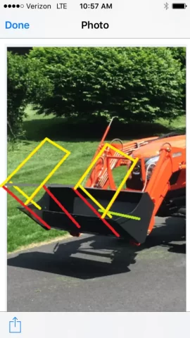

I'll post the pics later but tonight I'm going to build my own bucket plat form for wood hauling using 2x4's, 3/4" plywood and ratchet straps
[Hearth.com] Anyone Burning Yet?
The bottom red lines are 2x4's the grey is the top sheet of plywood then the yellow is the top 2x4's, gonna wedge the bucket between them, then use ratchet straps on the sides to hold it in place, should work for now, not a permanent solution

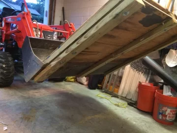

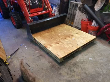

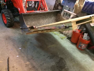

Coming along pretty good, used thru bolts to make a sandwich, strap to keep the platform from sliding out, now onto the sides, Gona make them 48" high, decided not to make a back shield because there's no good mounting area will post more pics when it's done

You may be ok to just stack east-west as is. I personally wouldn't add side shields because I see that open platform as being useful for many other chores!
BTW, good job!

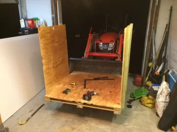

[Hearth.com] Anyone Burning Yet? To late lol
That'd be one mean Kioti:)

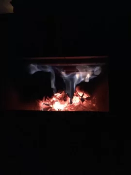

I started it up on Saturday when it was 37* F outside. I opened 4 windows and 2 doors and a slider and started a mild burn. The room maintained 74*F even though I was using 2 room fans to remove the smell. The odor wasn't bad.
