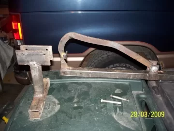

Rather than build it like a blacksmith I'd build it like a welder. I wouldn't bend it to make the hook, I'd weld pieces together to make the hook and then I'd grind the welds smooth. Barring that if you could get access to some half inch plate and a plasma cutter you could come up with a stout hook in pretty short order I'd think.
IIRC correctly that's what the guy that built his out of square stock did. I can see where that would be a great way to build it. I have a cheap HF welder, but I do better at burning holes in things than joining them. I really need somebody to teach me how to do it.
Matt

Here ya go.
  • [Hearth.com] Anyone built their own Cant Hook?
thanks for the pic. that helps!
