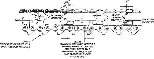

I had good luck converting a regular chain to a milling chain. Below is a diagram, but generally I used a bench grinder to grind the wide part off half the teeth to make scorers. So it would go L scorer, R scorer, L cutter, R cutter. Then filed the teeth down to 5 degrees (not zero in the pic). I just did the first maybe half of the tooth and then every time I resharpened I'd get a little more off.
FWIW the milling chain wasn't really any faster, it just cut smoother and left a very nice finish on the boards.
