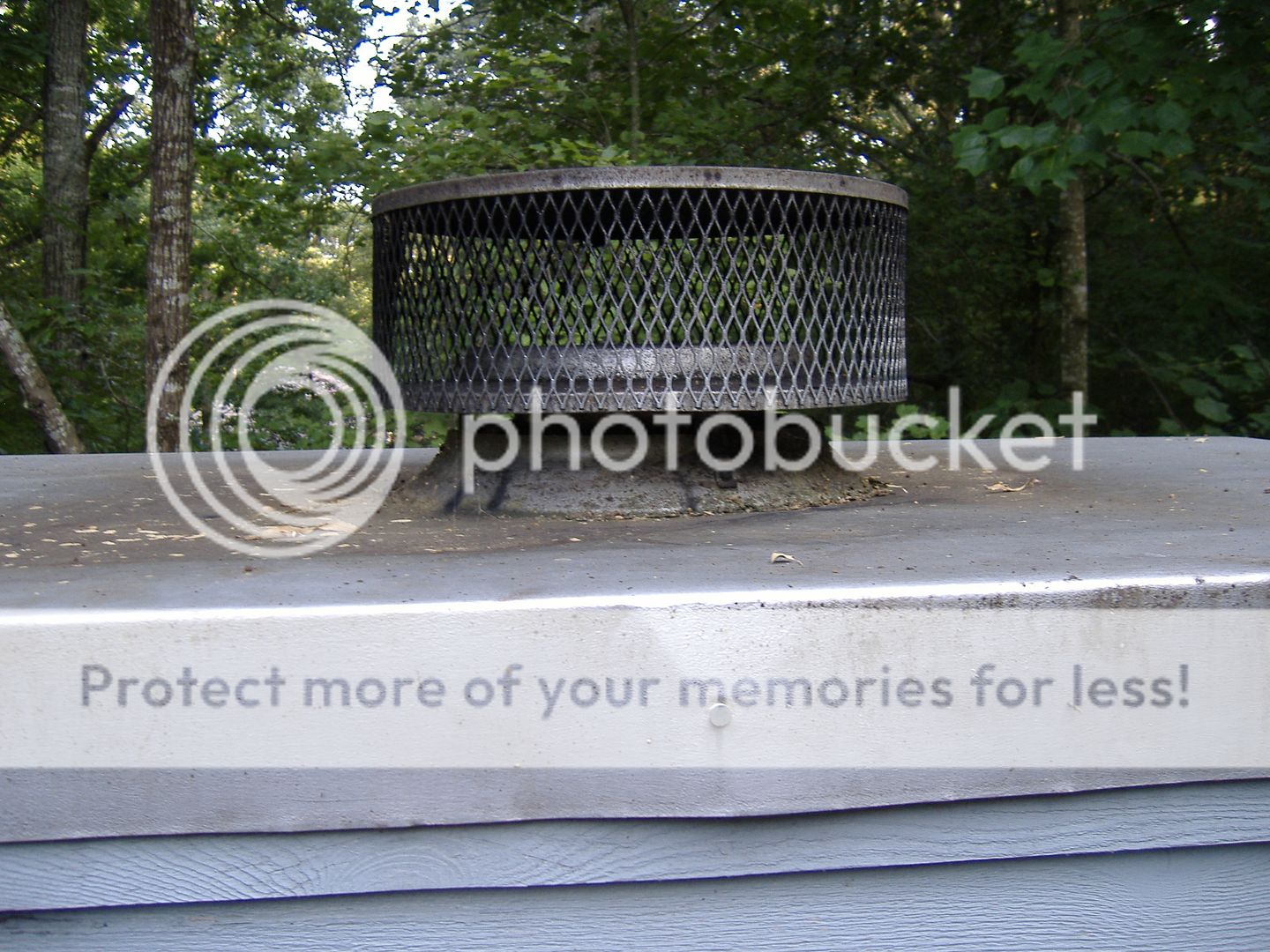

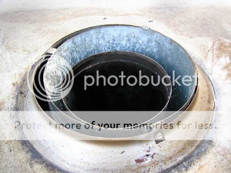

I am close to buying my preinsulated liner from firesidechimneysupply as I was advised the sell the preinsulated liner that replace the maganflex I was looking to buy. Anyway, the fella I'm working with there has been very helpful but he's not sure he has a cap that can be used to terminate the liner. Here are a couple photos of what I am working with:

My current cap has a 12" extension you can't see that slides down into the center 8" pipe. I need a solution that lets the air flow out of the outer pipe so I can't seal that off. I'm looking at the Homesaver liner caps but don't understand how they work in my situation.
More importantly it looks like you need a large storm collar to cover the the whole pipe. I wouldn't worry about outer wall venting too much. With an insulated liner that shouldn't be a big deal.
I am sorry begreen is absolutely wrong that pipe needs to vent in order to be safe. This is why modifying prefab stuff is a problem there are no parts made to do it and there is no testing done to check the safety of it. If you are going to do it you need to make sure you maintain that airflow and keep any debris or critters out of that cavity.

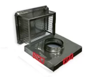

Not sure if this helps or not, just throwing out ideas here, see what sticks. Chimney Liner Depot (for example), Deluxe Cap. I guess I'd hafta think about the details of how this would all come together...anyways ^ >
[Hearth.com] Any similar liners like Magnaflex Insul-flex preinsulated liner?
1. Maybe the center section of the deluxe cap that the liner attaches to could be cut out and tin-smithed up in a way to sit on/attach to your existing flue pipe in manner so as to not block the air flow of the outer section. Then the remainder of the deluxe cap glued n screwed down to your existing metal chimey top...cap...cover...thingy. ==c <> :rolleyes:
2. Maybe this is a better idea, CLD, Terra Cotta mount Deluxe Cap ^ >

Mount 8 short pieces of stainless or aluminum square tubing, on their side, in L shapes, to your existing metal chimney cover so that they form a "square" the same inside dimensions as the mounting plate of the deluxe cap. The new cap can now sit on and be mounted to this tubing. Leave enough room between the ends of your "L brackets" so that you can cut out the center of each side of the terra cotta mounting plate, allowing the air cooled part of your chimney to breath through these 4 holes. Here's a crude example of what the heck I'm tryin to e'splain here (hey, it's late...way past my bedtime)[Hearth.com] Any similar liners like Magnaflex Insul-flex preinsulated liner? <^ black is the square tube "L brackets", blue arrows represent the cooling air, brown is the shmoke...[Hearth.com] Any similar liners like Magnaflex Insul-flex preinsulated liner? < ^ red is where you cut out for the cooling air flow...like BG said, prolly wouldn't be much of an issue anyways,, but better safe than sorry.
This solve all the issues? What ye think?

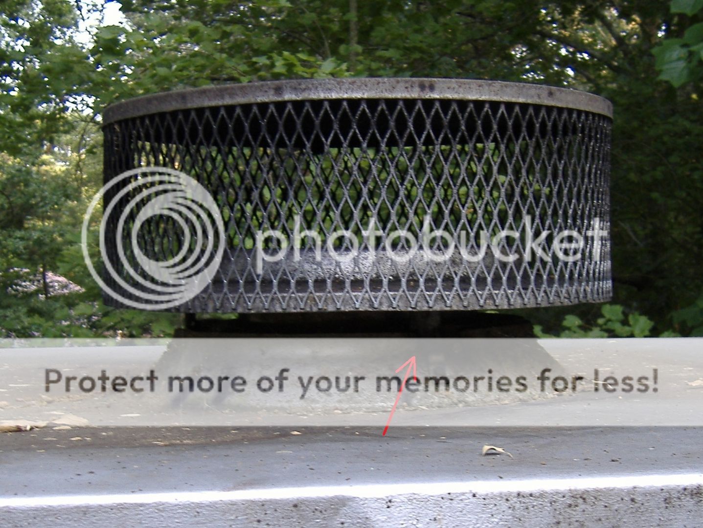

Unfortunately I'm still not comfortable purchasing my kit until I fully understand my top termination. My current cap uses 3 stand-off straps (see red arrow) that keep my cap up off the chimney to allow airflow from the outer pipe. It has a 16" pipe that goes down into the inner 8" pipe. I could cut this 16" portion completely off my cap and then reattach the cap to my chase cover using the existing 3 stand-offs. That, in my mind, would be an effective cap that allows airflow. And I can easily remove it as I do now to clean the chimney.
But it doesn't help me with supporting the 20' preinsulated liner from the top. I'm expecting about 40 lbs of liner to hang down. I will have a block-off plate screwed to the ceiling of my firebox with a collar that will secure the lower end but feel I need a secure termination at the top too. I've seen some have run screws thru the liner and into the inner 8" chimney pipe but 40 lbs. pulling down on those screws doesn't feel adequate to me. I don't feel I can screw it to my modified cap as I need to be able to lift/remove the cap to clean it annually.

Yeah, I figured it was gonna be a lil hard to understand what I was talkin about. Basically, you would take off the existing cap, bend down the 3 mounting tabs, leave the rest there, then you would be mounting the new cap to your chimney top cover, "hovering" above the chimney pipe so as to allow air flow through the outer pipe and out from under the mounting plate of the Deluxe cap The new liner then clamps into the new cap, and I also personally used stainless screws through the cap into the liner too. I really like the hinged cap, easy to clean, won't blow off! Lil pricey though...

Thinkin about this a bit more, I'm making this too complicated, This is just a regular simple install, only difference is that the deluxe cap is mounted on stand offs (square tubing) instead of direct to the chimney. Thats what I was getting at in my above post. I think you can figure out the rest of the details from there...
