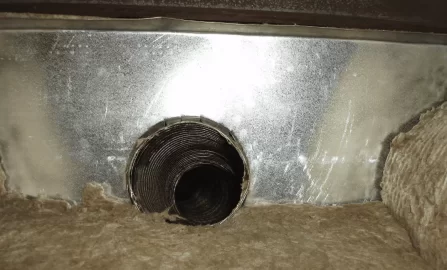

Here are a few pics of the install. Happy burning everyone! Hopefully no regrets! ;)

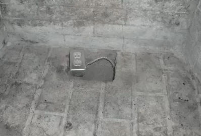

Wife did not want power cord exposed so ran flush mount outlet in rear of firebox in the old ash clean out hole.

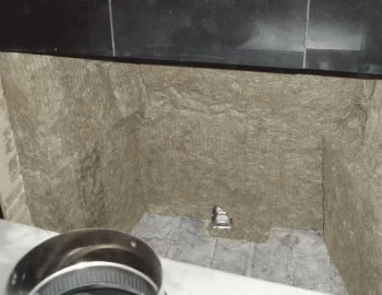

Insulating the firebox with Roxul fire resistant insulation.

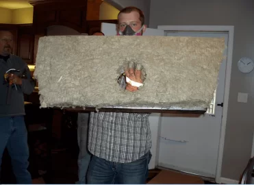

My brother's 24 gauge metal block-off plate with insulation on top side. Luckily he's a heating and air guy that fabricated this in about 20 mins!

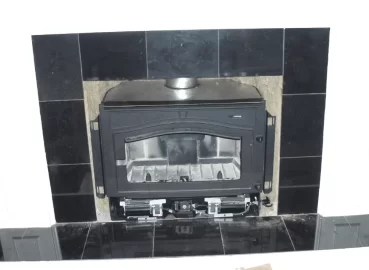

Final install after first break-in fire minus bottom surround. Have to get tiles cut for it to attach.

Beautiful installation.
One comment...I'm not sure you want that electrical outlet in the firebox... See this thread.
