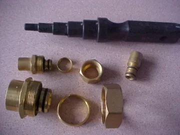

The fittings for pex al pex PAP have o-rings on them. They are available as a crimp style, or compression, here are a few examples.
You also need that tool which rounds out the tube and cuts a bevel on the end so the o-ring doesn't rip when assembling.
Regular pex fittings without the rings will leak, especially if the tube moves around.
Now Viega Fosta pex is a different animal. It has the aluminum wrap on the outside. A tool removes that layer and a regular brass crimp fitting and copper ring will work on it. Viega prefers you use their brand.

I used the PEX-AL and found it is MUCH harder to bend than the regular stuff the advantage is its self supporting and does not need to be secured as often.
It WILL NOT go up and down around floor joists not even close.
The fittings I used were the compression with O ring and they worked great however they are not available at the box stores just the plumbing supply shops.
