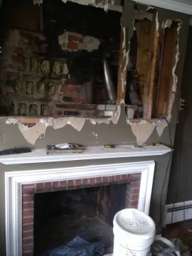

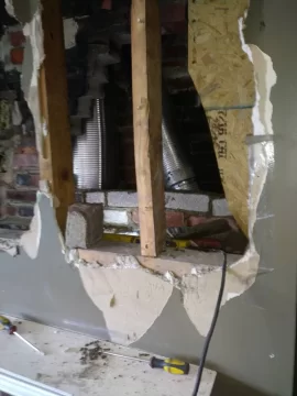

I don't have enough room to properly insulate in the bottom 3.5' and can't make enough room without risking collapse. So I will just make the required 1" clearance and the wall will be non-combustible as well. It is wrapped above but there is a section that was poured solid. I don't like doing it that way but I don't have much choice and it will be safe. I would normally just downsize the liner but this one was borderline on sizing already.Will the fireplace liner get insulated or is it already an insulated liner?
That chimney was absolutely built that way no modifications done. Built in 82. The scary part is that it really isn't very uncommon we just don't know untill it causes a problem or the wall is opened up for some other reason.
There was an entire development here built in the early 90 where every furnace chimney was 3 sided going up the side of the house they built the 4th side one they got to the roof. They all passed inspections just fine and no one knew untill one caught fire about 5 years ago.

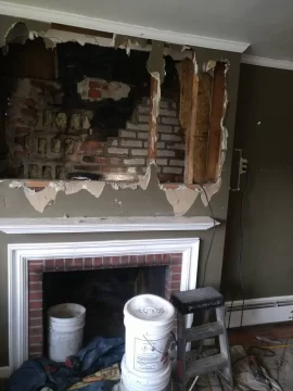

Did an inspection today to repair after a structure fire. Anyone see any problems?

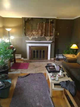

Now it's up to the carpenters to finish it off.
I don't know what their deductible was. The bill was $12000 but covered by insuranceLooks great! Sounds like a PITA job. May I ask what this ended up costing the homeowners? Just out if curiosity. They should get an insert if they have any money left![]()
