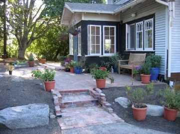

It's taken us about a minute per brick on average to clean and stack the bricks from the old fireplace. My son has done a couple hundred so far. Old mortar comes off pretty easily on most of the bricks. Newer bricks and mortar are another story. Tools of choice have turned out to be a hammer (for big chunks of mortar), a stiff 4" scraping blade and a wire brush. Now they're being recycled for steps and landings.

Thanks, though to be honest my son is getting .25 per brick. But we do like the look. We wanted to do something that looked like it had been around awhile.
Warren a long time back I moved a home to another location but the last 4" of the existing foundation was 3 rows of bricks.
Instead of bull dozing them, I made off with a couple dump truck loads., My front walk and patio area has the used brick I cleaned I also had enough To face a chimney on a house I was building I saved some $$ there
BTW nice looking brick work
Wow BeGreen, the house is looking very nice. Never would have guess it was up in the air and had no foundation a while ago. Walk is really nice. The use brick is great.
