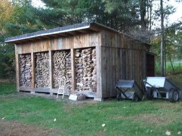

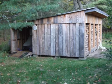

Yup . . . this is my shed. I think I have a 2-3 foot overhang.

Wow!
Is that about 8 cords capacity?

That's just awesome, you build it yourself? What's the floor constructed of? I don't know how I haven't seen it before.
If you don't mind me asking... what'd it run ya $$?

If memory serves me correctly (and it doesn't always do so) . . . I believe it's 12 x 20 or 10 x 20 . . . at one time I figured I could easily get 8 cords of wood in the shed . . . which is very nice . . . I end up using half of it in one winter and then restock the shed with wood for the second year . . . it's just a very good feeling when you have two years worth of wood under cover and another year's worth of wood outside.

Yes . . . I built it myself . . . one of the reasons it is as large as it is . . . I built some of it on the cement pilings used on a giant swingset that was in our backyard.
I used the cement pilings, block and rocks and built the floor out of 2 x 12 (maybe 2 x 10) rough cut cedar . . . bearing in mind the heavy weight load the joists are something like 12 or 16 inches on center and I have supported each stringer underneath. On top are rough cut cedar planks.
Since I was able to re-use many of the 2 x 4s (many nailed together to make 4 x 4s) by tearing down an old camp I think I have maybe $500 or $600 invested into this . . . however as mentioned my memory is pretty bad . . . a search for the original thread might show you if my memory is truly all that accurate or not. I know I paid for the flooring material, cinder blocks, nails, a few 2 x 4s in the walls, the 2 x 12s (could be 2 x 10s) for the roof stringers and some shingles (some other shingles I scavenged off the walls of the old cabin.)
