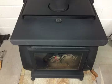

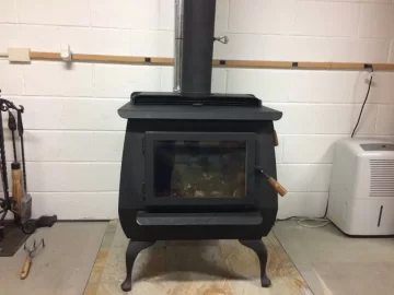

Yup. The wood is from the same stack. I will say maybe I'm burning at too low, which is causing the black window. But that is because I'm having trouble with the damper. Which I could be another complaint. On my PH if I'm looking for "low" I just turn the damper all the way down. On the Ashford I had to find low on my own. If turned it all the way down the fire would go out. But hey it's still early in the competition, maybe by February I'll be loving it. Sorry if you couldn't follow my last post too well. Been busy with the holidays, and that post was hastily written in the mall tied the hitchin post with the rest of the husband's.
Sent from my SM-G900W8 using Tapatalk
When you said "the fire would go out" are you talking about the flame? is the cat that goes inactive?
I have the princess not the ashford but i believe they work under the same concept. It is normal the fire to go out when you dial it to low, the tstat will open and closes to keep almost a steady heat output as need it. one of the family member crossing the street from me bought one after i got my princess and the tstat look the same than mine when we talk about the sticker, they burn on it the same way i do mine and no problems till now that i am aware of. I can burn mine with the knob about 1:00 clock almost at the end of the top of the sticker and never goes inactive.
including when looks like there is nothing in there and look just ashes after 22-27 hrs my cat still around 9:30 to 10:00 o'clock with 300df stove top outside temp low 20s. then i rake the ashes and lots of coal under, rake to the front and let the air open, i see 12:00 o'clock in the cat or more and temp climb into the 400s for almost two more hrs. they are seeing almost the same performance with their ashford. I know I have good draft and looks like they are doing good too. i found that to get max heat from this stove i don't need to see flames at all. the highest i go with the tstat is at 2:30 and the temp on the stove stays oscillating between 550-625 for almost 5-6 hrs after reload. kind of heat that sometimes is to much. i keep it about 1:30 and runs about 400-475 the most and super long burn. Oh, the whole point is: NO FLAMES AT ALL.

Yes the cat will become inactive below 3 o'clock on the sticker, then the stove will start backpuffing. I do know that she has poor draft.

Notice, no flames cat probe @ 1 o clock, and well the blower is on low, this will run like this until tomorrow morning at 6am.
Yeah, that's exactly what I am able to get. And I understand straight Cat proformance. All Im saying is it took me a few tries to find the sweet spot on the damper with out deactivating the cat. I also understand that Bk windows remain black most of the yr. That's why I choose the PH since it's in the center of my open style home. If I had a basement then I would have went with a Bk.

The PH also has two panels for the window, the BK only has one. For the PH, this serves to keep the inside glass hotter, reducing the black buildup.
