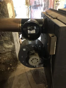

Installed a $75 barometric damper. Adjusted it wide open. Now my stove won’t hold a fire, even with the bottom door open. Any ideas? Thank you.
Close it more. What draft is required by the furnace? With it all the way open you will have very little draft.
I adjusted the weight all the way to the left, so the door is perpendicular to the pipe. Before that, when it was “open” more it let smoke into the house.
If smoke was coming into the house through the baro damper there is something very wrong and very dangerous about your install. There should always be negative pressure inside that pipe pulling in which will not allow smoke out. The damper is also to close to the stove most stoves want the 18" from the outlet. You really need someone with real knowledge of coal stoves and furnaces to look at your install.
No one like that is available. I think as soon as the coals cool off I will take it back out. KISS applies to me, the installer.
Ok but if smoke was coming out the damper something is very wrong with your install. And it is very dangerous.
Ok, well, thanks all. My plan is cool off the stove, remove the baro, and go back to original install.
I appreciate all the input, but referring me to a qualified installer is of no use to me. I am a rugged individualist, do it yourselfer. I live in a township of the same types. When I rely on others, I spend money and get nothing but grief (see earlier post about renting a lift and hiring a guy to install chimney which costed a lot and had ZERO results). I was hoping someone in internet land had this kind of stove, or a similar one, but no luck. I gotta go back to the big wide world of people who do not have computers.
I read and re read the baro instructions. I have read the stove manual mAny times. There is no information or settings for a Baro. The manufacturer sold me the baro but did not understand why I would want or need it. He has many of these stoves in use on his farm - I counted five in house, green house, maple sugar shack, workshop, retail shop, etc. and probably more I don’t know about. Short stacks and tall stacks. No baros. Leads me to think mine will work best without one.
