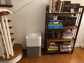

Thanks to the suggestions here I purchased a blueair unit last night. Best buy has a good sale going on now, about 130$ cheaper than normal price

nice unit looking at you pic the size is what holds be back from getting one.. Frigging thing is huge
It's really not as bad as it looks. The WAF is also very high, which helps.
