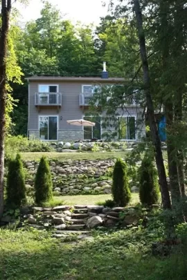

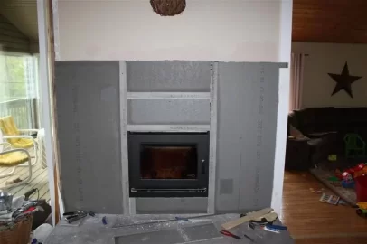

A little background … we have a large space to heat and a bit of an awkward layout. The building is over 3k sq/ft with most of the living space on a main level and a ½ story upstairs with 3 bedrooms and a loft open to the main level. The “great room†had a superior BR36 in it which I replaced at the tail end of last winter with a Ladera. The season pretty much came to an end as it was being finished so I haven’t had a good chance to see how well it will perform but I know it will be limited. Have had a couple of burn in fires and it's already 10X better than the old superior that's for sure. It certainly wasn’t my first choice but rather out of necessity given the clearance restrictions I was faced with and our current chase being set up against a load bearing wall. For the price and the other variables I’d like to think it was a good choice for replacing the smoky BR36 which I loathed each time I fed it. (even tried to make a grate heater for it!) Anyway the install is just about done with just the remaining facing to be completed up to the cathedral ceiling and a trim piece over the louvre which I plan to do over the labour day weekend. Here are some before an after shots – sorry for the B&W – kids got the camera into B&W mode and I couldn’t figure it out.
