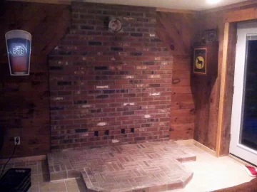

So we have finally decided to take the plunge and get a wood stove, itwas between wood/gas or pellet for a while, we decided to go with wood since it is the cheapest stove to get upfront and we have alot of oak trees that we will be cutting down overtime on our property which will help with fuel costs
currently the entire house is electric heat and last months electric bill was enough to make us take the plunge.
We have a 1600sq foot cape which includes half a finished basement, which is where the stove will go. We only plan on burning 24/7 on the weekends or on really cold stretches. I know the heat will most likely not make it up to the 2nd floor, but i think the 1st floor will benefit from the heat rising up the stairwell and through cut-outs in the floor that the previous owner made. (fire hazard i know)
I have been to two local stove shopes to see whats available in my price range.
One stove i found for around 1k$ i believe was the napoleon 1450? anyone have any good or bad experience with that stove?
can anyone else recommend a good stove for my situation around the 1k$ range?
The stove does not need to be fancy, would like something that can heat hte basement and the first floor without sweating us out of the basement. Stove also needs to heat up fast (I like the idea of the soapstone, but they are more $$ and take longer to heat up)
Fortunatly there is already a hearth and a chimney, one one piece missing. (picture)

The Englander 30NC seems to be a good one. Most are pretty happy with them. I've seen them recently for $799 at Lowes. Nothing fancy, but a solid dependable stove.
What he said.
Oh I guess I might kinda, sorta recommend the 30-NC. Fourth season heating this barn with one and don't plan to change. Wish I had your hearth setup.
Napoleon 1450 = 2cu ft stove, Englander 30NC = 3cu ft + stove. If it's heating capacity you're looking for the Englander is the best bang for the buck of the stoves mentioned.
Lovely hearth set up !! Can't wait for the finished pics !
BB's mentioning the Englander even with the clearance prices, must be something to look at ;-P
*This BB paying for his stove >:-( *
J-Man said:
What he said.
What he said again. If I could have fit it I would have one. I went with it's little brother the 13. LOVE IT!
another one for the nc30 ,its packs a punch it will be all you need for that size house and has some great modern epa features with a clean long burn time ,pretty much just like the napolean but with a bigger firebox for those really cold nights where youll want to wake up to a toasty warm house.
