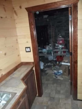

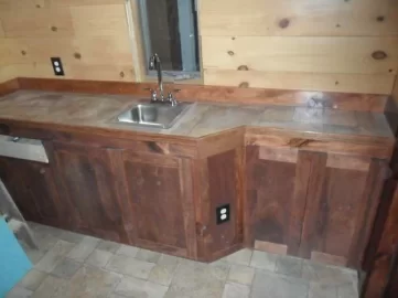

Well, the cabinet and counter top I made are just about done. Have to make the drawer cover and touch up a few areas, oh and clear coat and install the window trim. The faucet is just mocked up for now, want to get the window trim on before I install the faucet.
Far from perfect, but I am really happy with how my first cabinet build came out. Especially since I didn't draw anything up, just started building off a vision in my head and kept going. Should have drawn it up and I would not have had to change and redo a few tings, but it is almost complete and didn't cost very much.

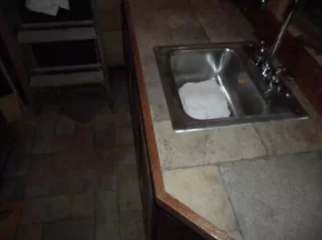

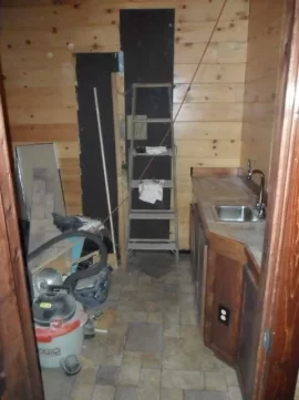

The wood is all pine, select for the doors, regular crap for the face framing. The counter top is made from the laminate flooring I had left over. The counter top edge trim is red oak which I cut a groove in the back side to accept the lip of the laminate flooring. I had to move an outlet that was originally in the wall which is not the back of the cabinet. And had to keep the whole thing 20" in depth as it is only 16" from wall to doorway opening and it would have been sticking out too far. Didn't want to be walking into the counter all the time. I tapered the end near the door to about 11". This proved to be the most challenging part, and I had to attempt to cut the 45 degree angle and then a straight away where the counter top tapers in. then cut a lip on the edge of the laminate to slid into the edge trim. This is where not having all those fancy proper tools sucks. But I did my best and it turned out "ok".
