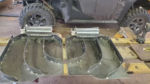

Just to be clear, are you saying the EPA instigated stoves are not necessary for a clean burn?What i don't understand is why you need second air for this. My stove does not have secondary air and I see the same flames wafting around in the top of the firebox (depending on primary air settings)?
I am curious why if you dislike the innovations brought forth by the EPA regulations so much why are you trying to copy them?Just to be clear, are you saying the EPA instigated stoves are not necessary for a clean burn?
Agree.This was a good thread to read along on.....
I only dislike what many poor folks are experiencing as posted readily on this great website. I keep my fires in check no matter what I need to do or despite what some government control advocate wants to tell me is right.I am curious why if you dislike the innovations brought forth by the EPA regulations so much why are you trying to copy them?
![[Hearth.com] Adding secondary burn to this unique stove [Hearth.com] Adding secondary burn to this unique stove](https://www.hearth.com/talk/data/attachments/293/293163-62e9d54d28e95cc62a7dd4267fef10d8.jpg?hash=8ZnKtaqdzQ)
Just install the stove to spec and it will be safe and controllable. It really isn't as complicated as you are making itI only dislike what many poor folks are experiencing as posted readily on this great website. I keep my fires in check no matter what I need to do or despite what some government control advocate wants to tell me is right.
Perfect burn
It's not complicated to me. Again those are your words.Just install the stove to spec and it will be safe and controllable. It really isn't as complicated as you are making it
That is not what actual laboratory testing shows.It's not complicated to me. Again those are your words.
I claim more efficiency despite what the EPA mandated. They fell short of what is easily accomplished.
The old Wonderwood stoves captured more available heat than the new stoves....lol
Again I would have control over that situation as well but I am confident he secondary burn will be active with fans running. If not, I can slow fans down of off. My old wood furnace at my primary residence has a large plenum and blower and the secondaries work very well ,....as shown in a previous post here.That is not what actual laboratory testing shows.
All the unburnt volatiles the wonderwoods sent up the stack was unused BTUs.
Installed properly modern stoves can run at very low exhaust temps (just above the condensation point) I really don't know how you think you are going to safely go below that. And if you are pulling heat out of the firebox you won't reach proper temps for secondary combustion meaning you will be sending unburnt BTUs up the stack
wrong pic.^I only dislike what many poor folks are experiencing as posted readily on this great website. I keep my fires in check no matter what I need to do or despite what some government control advocate wants to tell me is right.
Perfect burn
