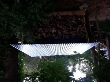

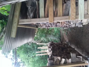

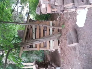

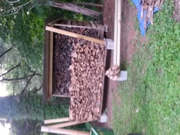

So I finally added a roof, put a center brace also. 5 2.5 sections. It ended up with a pretty deep overhang in the front which will come in handy in bad weather. [Hearth.com] Adding a roof
[Hearth.com] Adding a roof[Hearth.com] Adding a roof[Hearth.com] Adding a roof
I used a similar design for my shed. I would add more supports towards the front of the metal roof. Having an unsupported section with a few hundred pounds of wet snow will fold that section like aluminum foil.
Add another 2x on the end.
Hmm, I didn't think of that. That spruce next to it and maple to the side shield the area from a lot of snow. I guess I could a support at the end of the front, that's about 8-10" out.
Safer not to walk into also.
Well, if it gets like this year, which isn't probable, I could just use my over priced roof rake to pull it off from the back.
