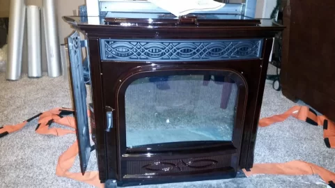

One other thought, my installer was very experienced, been to several Harman classes, and he had a bear of a time getting the back piece aligned such that the stove would slide in and fit correctly. There were several nicks in the finish as a result. It does not take much to damage. Take your time and think about putting some tape along the mating surfaces till you get it right. I am replacing the door as we speak due to a large chunk of the enamel coming off.

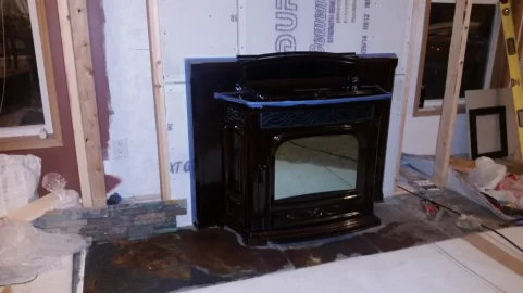

Insert is in just need the pros to stop out and ok everything for warranty purposes. Went smooth didn't chip enamel finish with the helpful hint of putting masking tape on edges it saved me a few times. Overall I am satisfied with how everything went together it looks nice. Need to finish stone work and put up a mantel. Picture don't do this insert justice I will post more soon.

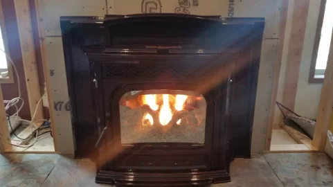

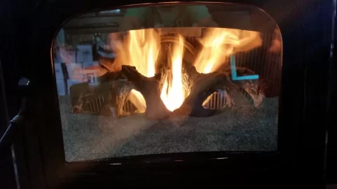

The pros stopped out and ok'd everything wooo wooo. Its up and running and the house is getting toasty, todays outside temp 10° so this couldn't of happened at a better time. What a way to bring in the new year. Thanks everyone for all your help on helping me achieve a self install. Now just to complete the stone and my living room will be back to normal. Cheers

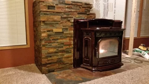

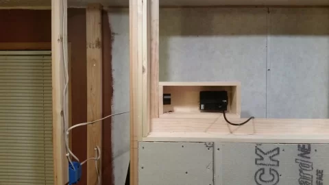

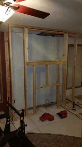

You gonna just run the stone up flush with the back casting?
Very nice install and that is a very good looking stove. Not nit picking just throwing out some info. Your bottom plate on your framing should be CCA or PT Pressure Treated 2 x 4. Anything that touches steel or concrete requires PT wood. No big deal at all and you are more than fine. Nothing to worry about. Just an educational bit many DIY's overlook and will likely get DINGED on by the inspectors.
Enjoy that stove and get some more pics up when you finish it all up. Had to go all fancy on us and enamel it and all. You uppity Harman folk. Not sure what I'm going to do with Y'all...........

Well thanks I've been working hard on it just didn't have as much free time around the holidays. The bottom plate is on wood that is painted white so it may look like concrete but it is not. I know about framing some and if it was not pressure treated on concrete it would not last. The enamel finish is what makes the wife happy more appealing since this is in our main living room. Temps here are -8 today so this thing is definitely doing its job. I'm happy and warm.
For some reason it looked like concrete to me. Likely because I didn't see wood and the paint explains that. Even better still! Our forecast just changed for the worse and colder. Not MN bad, but cold, cold. YUK!

I am with you on the project time getting thwarted. I was trying to get my second stove installed. I am also finishing the area of the house its going in so it's not just a cut a hole or two and slam it in. Your install is a bit more than a standard install project too but at least you had a finished space to start building your hearth and fireplace set up in. Too many interruptions here as well and I kinda turned into a holiday slacker. Time to get back to it though. Good Luck!
Regular lumber is OK on concrete and steel or should I say better IF in a controlled environment. Still not right, but better. Cool steel and concrete attracts moisture which rots wood. I have demo'ed very old regular wood from locations like described and it was as good as new. Then I have also pulled out new wood and it had the consistency of a mushroom. Maybe someone else will see this and take note. I learn something here every time I surf.

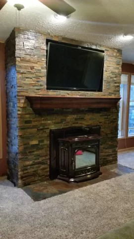

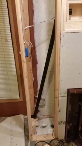

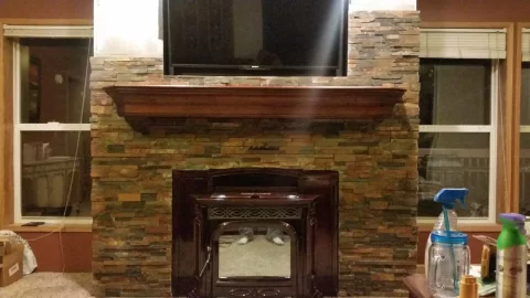

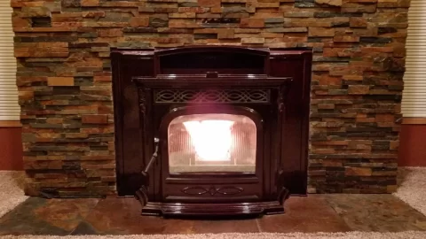

So I haven't been on here in awhile and wanted to post some updated pictures. I am extremely happy how everything turned out I only need to finish a few trim items. I put black abs pipe from back of TV to the floor so I can run some cables, also the 3/4 plywood behind TV is removable if I ever need to access the stove pipe or electrical wiring. On the left side of fireplace I mounted an outlet so in case I plug something in that is on top of mantel like christmas lights I dont need to run extension cords also located there is a dimmer switch for two can lights mounted in ceiling. Let me know what you guys think and I'm thankful for all the advise that helped me accomplish this.[Hearth.com] Accentra 52i [Hearth.com] Accentra 52i [Hearth.com] Accentra 52i [Hearth.com] Accentra 52i [Hearth.com] Accentra 52i [Hearth.com] Accentra 52i [Hearth.com] Accentra 52i
That looks great and I'm also considering placing a TV above my Accentra insert. Alas, I don't have the option of recessing mine.
Turned out nice. I'm thinking about replacing my old Lopi wood insert with a new pellet insert before nest heating season. We shall see???
