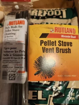

My Accentra 52i is a 2016 model and has a 4" vent, check your owners manual but I believe that is standard. Length will be determined by your specific install. Mine has a 4" liner that runs through an existing fireplace stove pipe in a chase, about 25' in length. I attached a picture of my brush and rod kit, I also have a few extra rod lengths to get my brush to the top of the pipe. Works good. I wouldn't think after 1 ton that you would need to sweep the flue? I burn about 5 ton per season and sweep the flue once usually in May/June.
