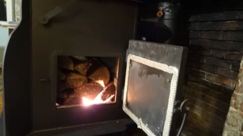

I installed an early model of the Absolute Steel Hybrid yesterday, and we are very much enjoying it (despite paint smell when it is 20 degrees outside!). My wife is loving the air control - it is at least as good as the Ideal Steel. We liked the Ideal Steel, but were not sure we needed such a large stove for our second (the Progress Hybrid will remain the workhorse).

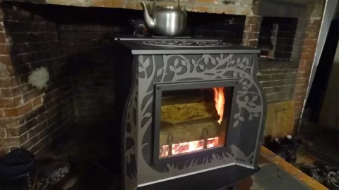

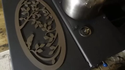

Loaded for the night.Primary draft acts more like the IS than the PH (the PH has a stronger draft coming down across the glass).
The firebox opening seems small, but I'm used to a larger stove. What is the opening size?
Thanks, now I see that this is a side loader. It looks like the front glass is 14.5"W x 13"H. The firebox is larger than I thought at 2.5 cu ft. Is it possible to load that amount of wood through the small side door?
That handle above the loading door- is that the bypass? What kind of burn times are you getting out of it so far?
Yes, the bypass handle comes down across the door - must open the bypass to open the door.
The stove is undersized for our house/insulation - we are testing it to see if we'd like it as a second stove, but right now only have one flue lined. So I'm not trying any low and slow fires yet. Going 7 hrs overnight we are having excess coals in the morning (still finding the right overnight settings, finding we can give it a bit more air than we have been).

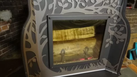

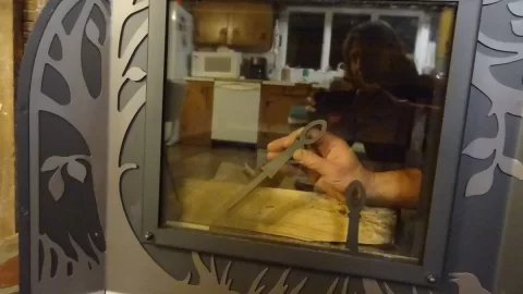

I tend to not load right up to the fireback on these stoves - usually leave a couple of inches. The front andirons feel a bit short to me (they lift right out for cleaning the glass (hear that, PH owners?!)), so I'm not crowding the front, either. I think you would need to play Jenga to completely fill to the top due to the height of the door relative to the height of the firebox.
The PH opening, for comparison, is 9 wide x 10.5 high, and the smoke shielding blocks off some of that.
{edit: I just looked in through the glass on the Absolute Steel - the top of the door opening is flush with the top of the fireback at the back (lowest part) of the sloped roof to the firebox. - You can pack it quite full if you wanted to.}
I think you would need to play Jenga to completely fill to the top due to the height of the door relative to the height of the firebox. The PH opening, for comparison, is 9 wide x 10.5 high, and the smoke shielding blocks off some of that.
These door sizes might sound small if you've never run a side-loader, but it sounds to me that the PH smoke shield would be a bigger impediment to loading full. The Keystone door is 9 wide by 9.5 tall. I think the Fireview door may be a little taller but has that 'Indian temple' shape, where the top corners cut in. Even that's not hard to load. As the box gets full, you have to put the top of the back row in first, when you still have room to slip the split back into position. Then the top front and lastly the center. When packing the small side-loaders, it helps to have a few flat splits on hand to finish off the top.
Nice! The Dutchwest has the lift-out andirons and I wish the Keystone and Fireview did. Don't really need 'em on the Dutchwest since the front door opens to clean the glass, but they sure would be handy on the stoves with fixed front glass. The Dutchwest andirons aren't very tall either, but you'll find you don't need much height to do the job.
