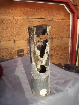

This was fished out of a home used as a liner. The older gent installed it or had it installed 5 to 7 years back. Unfortunately he did not have a tight damper seal. The medics were able to save his life from Co poisoning. He suffered brain damage and is residing in a rest home. He will never return to his home again. This happened in my town. I knew the guy guite well. You bet I never knew of this install or situation. it was done without a permit. The fire dept. called me in to confirm improper galzanized pipe was used as a liner.
This was the only whole section left the rest disingrated. And galzanized is suposed to be much less corrosive restiant than mild steel. Had this guy used a proper ss liner,, I could visit him at his home today. We were fellow classic car hobbist. He was a terrific mechanic
