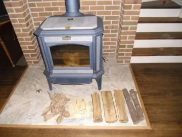

Here is a picture of what I'm predicting will keep my house between 68 and 72 until tomorrow night under the predicted weather conditions.
![A Progress Hybrid Shoulder Season Burn A Progress Hybrid Shoulder Season Burn](https://www.hearth.com/talk/data/attachments/74/74725-72d5fc1bc8b63bcf24d9dad2f3a1a05a.jpg)

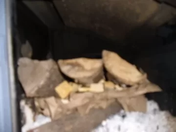

This is 10.5 pounds of wood (including 2X4 scrap as kindling). I did not weight the paper
. The wood includes 2 ash rounds of 2 to 3 inches and three ash spilts between 2X4 and 3X3 all in the stack about 1.5 years.

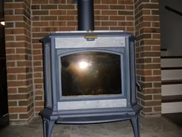

Here is "all" that wood loaded up in the PH. Room to spare! Keep in mind, that paper appears to fill almost as much firebox as the wood.
![A Progress Hybrid Shoulder Season Burn A Progress Hybrid Shoulder Season Burn](https://www.hearth.com/talk/data/attachments/74/74726-87ca415a90871f910c2376abceccda2f.jpg)

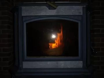

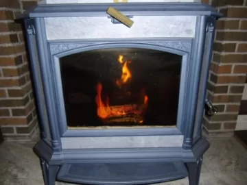

And here is it burning after two minutes (fire lit at (9:18 pm). Excuse the brown glass. The glass does get brown under these burning conditions, but burns off clean with a nice hot fire.
![A Progress Hybrid Shoulder Season Burn A Progress Hybrid Shoulder Season Burn](https://www.hearth.com/talk/data/attachments/74/74727-5cc2639dfad3e84d50cc60bc9ed60f6d.jpg)
