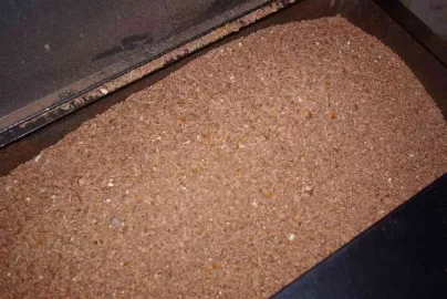

Here are a couple pix of the shells I use.
Snowy
  • [Hearth.com] A new stove MAYBE
