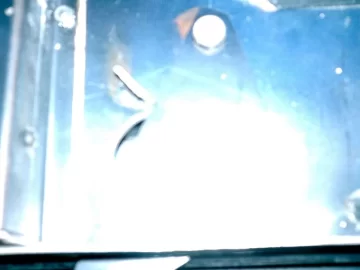

This is what the air control looks like on ours with the inlet damper wide open.
  • [Hearth.com] A Little scare and a  few ?? on my PE Pacific insert.

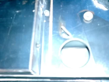

And this is how far it closes (as viewed from underside of stove, with ash drawer removed).
You probably can't see that on your insert, but this illustrates that the air control is made not to close completely.
Sorry for the crappy pic.

That;s not the slide In talking about. The lever itself slides horizontal through a cut out in the lower shield of the stove. It hits the cutout on the left but has room to spare on the right. Its a cutout thats about 1/4" high and 16" long. It is not the air inlet itself just the lever that operates it.

The slot where the draft control arm enters the stove isn't precisely cut to the exact position of the arm when open or closed all the way: it is wide enough to accomodate the full throw of the slide plate on the other end of the arm on various models. When the lever is moved as far as it will go towards the low position, the slide plate is closed to the tiny slit shown in the photo above. In other words, looking at the slot it can appear that you should have more throw than you do on one side, and less slot than you need on the other. Not the case.
