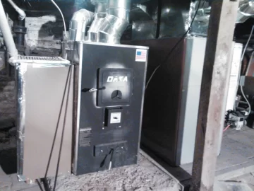

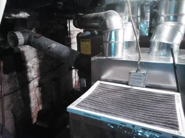

Daka 521 I installed week before thanksgiving. So far so good with this unit have had some stack temp issues but seems to be fine now after adding a barometric damper.Heats my 2500 sq. non insulted farmhouse no issues even at -10.I ordered it with out a fan and used fan and casing from a burnt out oil furnace I cut in half and matched to the side of the unit. I wish I could have piped it into my return air but I don't think it would be easy given location. Cleaned 35' exterior chimney yesterday and not much came out which is great considering some wood is seasoned and some not.
