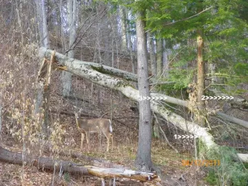

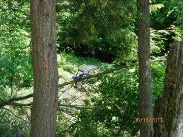

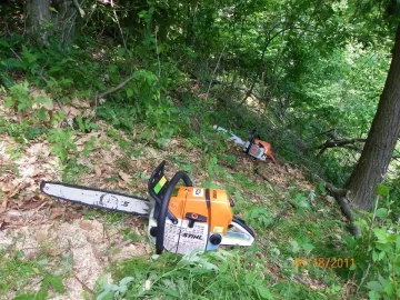

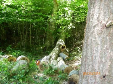

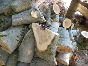

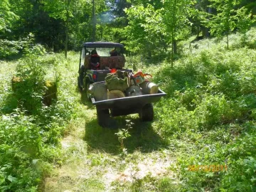

Went back in this morning and spent from 10 - 2 cutting this Beech. In the first picture # 1 the main trunk carried all the pressure so I started cutting # 2 which I left some then went to # 3 and cut until right behind the pine tree.
Went back to cutting the main trunk (#1) and after about 5 or 6 rounds it cut loose from the stump which I was hoping it would do, went has planned so it was a safe cut.

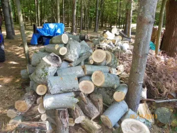

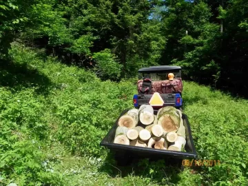

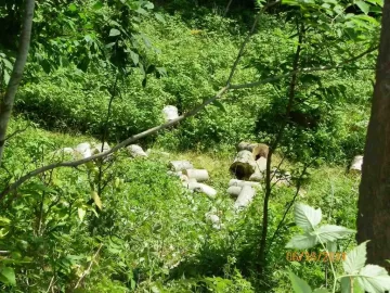

Attached are some pictures from todays haul, two loads of beech. In picture 3201 I ended up noodling it.

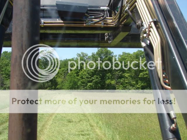

man zap it was a billion degrees at 2 this afternoon ;-) good for you...
there are 2 nice dead ash in the woods that i cant get a bead on with this pic.
but will be going back for them for sure :cheese:

Nice haul, zap.
Did you photoshop the deer, or was he stupervising?

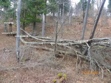

Thanks Billy, I learned a lesson two years ago on a big basswood that was in a very similar position on that same hill. The trunk of the tree cut loose and took off down the hill swinging the top of the tree back at me. I was worried about it and had cut some off the top then would step back and away from the tree, glad I did because when the trunk of the tree cut loose it swung up (top of the tree) towards me.
After that happened I called it a day and some of that tree is still on the side of the hill.
Zap
It sure is something to watch a tree take off down hill! Good idea to leave it hooked to the stump until you are done blocking it up. Its scary enough when you are branching a big limby tree and it rolls at you.
Billy
Billy

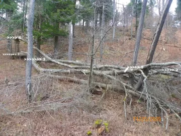

I'll give this a try, 1 is the part that took off down the hill after some of these cuts, started cutting at 2 behind the cherry tree all the way back to 3, then started on 4 from the top back to the stump, after that I cleared everything behind me and in front so I could work on 5 back to the stump.
At the time we had about a 6-7 inch gap between the basswood and both cherry trees, standing on the uphill side I positioned myself behind the cherry and cut it on a angle while stepping back and thats when the part near the stump took off. My end came up then back down within seconds.
