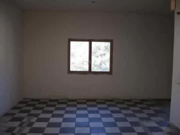

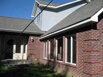

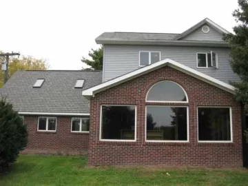

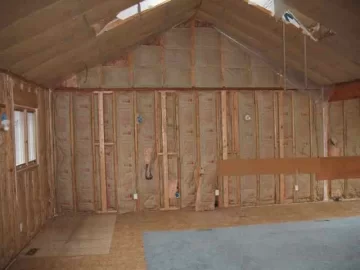

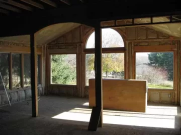

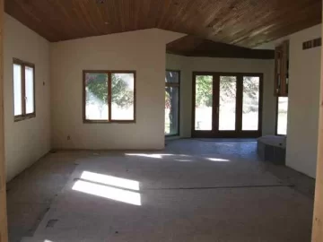

OK first off congrats. House seems to be fine, from what you have shown us.
I only see one partially finished floor in the photos & that is a good thing as it will allow you to consider radiant floors where the tubing is laid directly on top of the subfloor, there are several manufacturers that make systems specifically for this type of application.
I am sure that the trade pros as well as the trade engineers here will give you plenty of info to consider on the topic of what type of radiant to install.
I know you said you wanted to use the forced air to control costs however there isnt a more comfortable type of heat to be had than radiant directly under the finished floor you walk on, worth a good hard look IMO.
Forced air will be nowhere near as boiler friendly as radiant. Going this route would also allow you to place the boiler in the basement & run pipes to zones from the boiler.
The downside would be having two new unused furnaces for sale, the upside would be using that money to pay for a boiler & radiant tubing.
In photo #1 there are several posts in the wall that I will assume are for a faux post & beam look (correct me if I am wrong) they need vapor barrier behind them, all the electrical boxes in exterior walls/ceilings also need a vapor barrier hat on them prior to installing the vapor barrier on the walls (standard code requirement here I assume there as well).
You have a larger home with a fair amount of glass that will translate into a large heatload.
There appear to be cathedral ceilings on most of the first floor, hot forced air loves to rise up to those ceilings, radiant will keep you warmer near the floor where you live.
You didnt mention how much R value you have in the ceilings, that will factor into you heatloss calc as well.
What you suggested, using the existing ductwork to heat the home is doable I am just suggesting that there are alternatives, forced air will gobble up a ton more btu's to heat a home of this type than radiant no matter what you burn to generate those btu's.
Posting pics of the basement will help the heating pros to assess what will fit in so to speak. In short keep asking questions & keep an open mind about the answers you receive as I am sure there will be lots.
