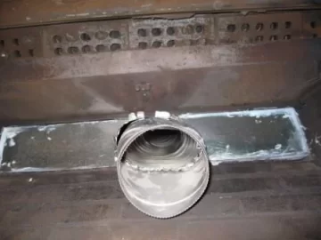

I think the major function of the damper block off plate is to trap the heat at the fire box level. Creating a more efficient use of the heat created. I included a pic of my after market damper block off so you would have a better Idea of what it looks like in place. The only thing missing from the picture is the rock-wool I stuffed between the liner and the block plate after the insert was in the right spot. hope that helps.
