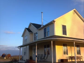

Finally, chimney is up, tile is down. Fire on Thursday....View attachment 84709 View attachment 84710

Thanks. I am happy with the way things went. There were no real surprises. Everything went as it should have, it just took time. She lives about thirty minutes away, so I really didn't do anything unless I could dedicate the whole day. Then I had to coordinate schedules with her friends that have a Sky Trak to get on the roof. I did the flashing and first section of pipe from a ladder, but the last two pieces of pipe and the brace were a bit scary with a 10/12 pitch. Now to finish the trim.
Pretty basic on the install. We had to keep the footprint as small as possible. Clearances aren't bad with this stove, but it ia just big to begin with.
There is just over $1k in the stove, which looks and works like new. Another $1800 or so in chimney and flooring. Not too bad. It will pay for itself by next winter.
