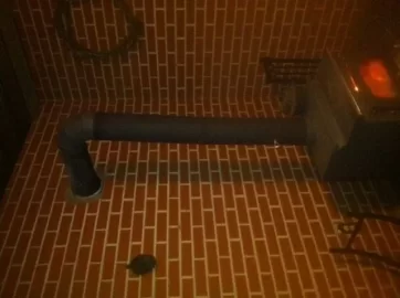

I am looking at the Drolet HT-2000. The manual says my flue needs to match the stoves diameter. It is an interior chimney. I have black stove pipe rising to a 90 then into the chimney. I can get a 6" liner down the chimney its only 10 feet. But not wrapped in insulation.
If the chimney was properly installed with a 2" gap from any combustibles then no need for the liner, but it would be safer to have one. You should not use fiberglass insulation for areas in direct contact with the flue. Use mineral wood insulation (Roxul) or ceramic wool (kaowool) instead. For a small job getting a small amount of kaowool would probably be cheaper and with less excess.
