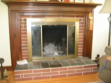

I hope the first post was not too long. I was trying to keep it simple.
I am including a picture of our current setup.
One question I have is how far over and up does the brick go? I know that I can determine this by taking off the mantel yet I am trying to design this as much as possible prior to this step.
I welcome your thoughts and help.
Scott

I bet you'd be ok with a heat shield. You may want to check into that before you do anything rash like remove the mantle. I would never go with a resin tile on a hearth/mantle area. Good to 170 may be ok, but your mantle is good to over 170. If you have to do the work then you should go ahead and put in real tile/stone. It's a hard/expensive enough job to do once... much less having to redo it after an overfire.
When you say heatshield are you suggesting a piece of metal over the existing mantel surround.
Do you know what the temp is around the mantel area?

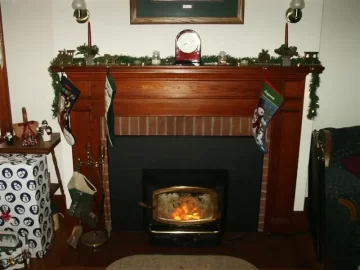

I had a very similar fireplace and mantle in my old house, except my hearth wasn't raised.
I installed an Avalon Rainier (90 degree flue model) to push it in farther into the fireplace so it wasn't sticking out that far at all. (Less radiant heat off the top.)
I still didn't meet the clearance requirements either so I just told the inspector I was going to install a heat shield but I never did.
The mantle did get pretty warm but never hot enough to do any damage.
You an always install a heat shield afterwards if you're still uncomfortable, but I doubt you'll need one if you go with a more "flush" type of install.
It would be overkill to modify your whole fireplace and mantle.
That's just my opinion.
EDIT: If I can find a picture, I'll post it.
Found a picture!

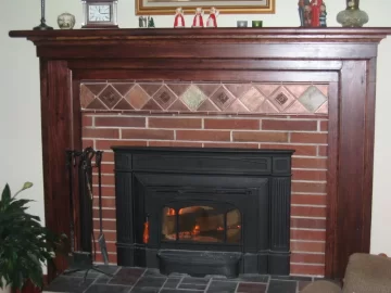

Did you ever finish this project? Wouldn't a mantel shield solve the problem rather than pulling the mantel and everything out? Would love to see a pic either way! (I searched this thred out because I was looking at the harmon insert.)
Yes, I did and sorry to say I have been remiss in posting any photos. Well better late than never.
As noted my wife was very adamant that if I change the mantel we would be selling the house. She had fallen in love with the fireplace.
I found a carpenter who took measurements of the mantel and made an expanded replica of what we had. For a cost of about $350.00 , I stained it myself
The top brick stopped about two inches from the bottom of the wood and exposed combustible material. This is why the tile along the top of the brick. As noted in some other post I was not sure if the tile material for some if it is not stone but a composite. In two years I have not found it get too hot so I am very happy.
This is a picture of the new setup. The picture in the second post is the original mantel.
THANK-YOU everyone for your help.
