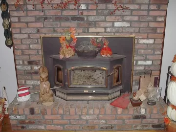

Here is a pic of my quad 5100 insert, the surround is 47 X 31.
I know I will get lots of abuse about the wife stuff piled all over and around it, and needing cleaning. When fire season starts all of her stuff is gone, and I am waiting for my new brick set to come in before doing the pre-startup heavy duty cleaning.
I am happy with it it puts out lots of heat, the blower could be quieter but that seems to be a complaint with most stoves.
