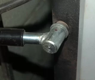

Somebody recently suggested putting high-temp axle grease on the damper, which they said worked. It does go away over time, though in my case, it will occasionally crop back up. What I did was to turn the firebox handle around so that you can open the door when the bypass damper is closed. I just drove out the little setpin holding the handle in place, turned the handle around and reset the pin. I think on the newer models you might have to grind it off. Anyway, with the door open, you can poke the damper open with a broomstick or some other long tool. Preferably when the fire has burned down to coals.

Here you go. This is from an '06 EKO 60, so it may be different on newer boilers and different models. Note that my handle is upside down, so the opening to drive the pin out is on the top instead of on the bottom of the handle. Nothing to grind off--just stick a nail set into the hole and drive the pin out. At least on mine.

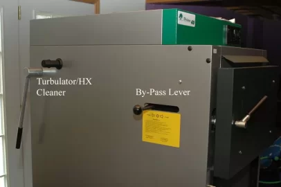

Here is the By-Pass lever and HX cleaning handle set-up on the "new style" EKO.

Will it let you open the firebox door when the bypass damper is closed? I wonder if the new ones stick.
Eric,
Yes, the loading door may be opened with the by-pass opened and/or closed. I will note, however, that it takes a fair amount of force to move the by-pass. I would describe it more like a deliberate motion, if that makes any sense. I have to actually grab the lever shaft instead of using only the ball, otherwise it feels as though it wants to bind on the internal rail or joint or whatever is actuating the flap.
Ben
Mine was rubbing against the shroud when I first got it. A little work with a Dremel took care of that problem and now I'd say it moves easily (when it's not stuck). You might want to check that and also put some high temp grease or graphite lube on the moving parts.
