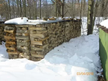

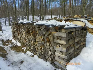

We stack 3 rows together and stack at 4 1/2' high.
