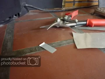

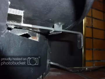

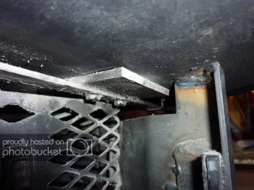

The other source of too much air was that the plates on the right-side air control slider weren't sealing off the openings tightly. Another Buck 91 user had the idea of removing the plates from the rod, taking the rod out, and bowing it up slightly in the center, so that it holds the plates closer to the openings. I heard that idea too late for my time with the stove. But I did put some shims in the rod holders, which raised the plates closer to the holes.
Now, if you get the plates sealing off the holes better, there's a risk that you might crash the cat if you cut the air too far. You need to know what you are doing to run the stove well..took me a while to figure it out.
