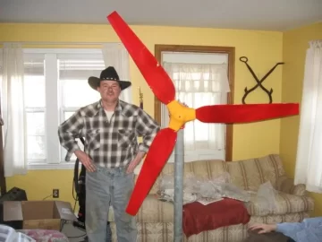

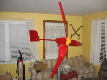

This isn't working so well in the living room.
I don't have it up yet so I do not know if I am happy with it yet or not.
This is my latest project. ARI 600 windgenerator. Hopefully I will have it setup outside in a week or two. I am kinda eager to see how well it actually works :!: I don't think it will repay my investment but I just classify it as a toy. And any power savings would be a +. Hopefully painting it 2150 IH red will make it work better :D

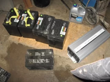

Power inverter. You need a power inverter big enough to supply
what ever you are going to power with it. (and enough battery power to
supply the inverter) I got a inverter big enough to power the whole house
except the 220v appliances (cloths dryer and well pump for me) I found a
good 5000 watt inverter that was only about $50 more than the 3500 watt
inverters which are the main large inverters right now. I got a Aims 24v
5000 watt inverter for $469 with shipping
This is the inverter and batterys for the battery bank. The battery off to the side is one out of a 91 ford explorer just to give a idea of the size.
http://www.theinverterstore.com/the-inv ... -front-rgb

The picture is my power inverter and batterys for the battery bank.
For some reason there are not image tags here for me to post the picture where I wanted to put it.
