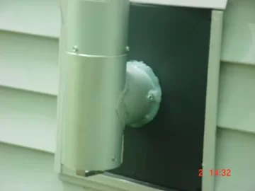

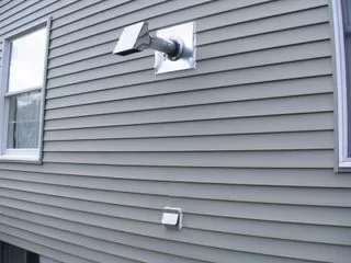

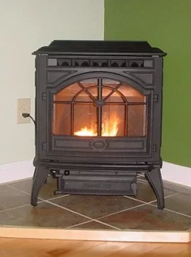

Hi, here is what mine looks like and a link that describes how much vent pipe you can use and still have your stove work properly. My vent setup adds up to 17 and still seems to work ok but I wouldn't go any higher than that.
You put the silicone on the outside of where the vent pipe twists together. And around the exhaust pipe and adaptor.
http://www.nevelsstoves.com/articles/Venting-your-pellet-stove.htm

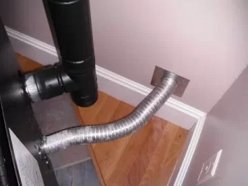

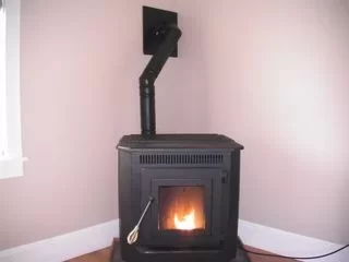

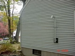

heres mine :red:

I agree, pictures do help a lot when people are new trying to figure stuff out, especially when the stuff can cause real harm if not done correctly. For our stove, the back of it juts out from the middle of the stove to the top but is in farther at the bottom, where the collar and t connect, this makes the pipe basically up against the back of the stove since we need to go up about 4 feet before we go out, does anyone know if that is ok? I'm also a little concerned about being near the water pipes, I'm sure that the pipe itself gets very hot when the stove is burning so I don't know if it is safe to have it close to the copper pipes and I haven't been able to find anything mentioning this situation. Our stove is in the basement and so the pipes run overhead the length of the room on the wall we need to go out. If I can get some opinions on this issue we could do the venting with just the T and 1 elbow, which would be ideal, I just want to make sure it is safe. By the way, thanks for helping and sharing your setups guys.
sheranjem said:
I agree, pictures do help a lot when people are new trying to figure stuff out, .....
and also when we try to help people with their installs. It would help A LOT if you could mock-up your stove and pipe, and take some pics of it, plus pics of the general room area where the stove will be. I'm sure you will get a lot more helpful responses from that.
