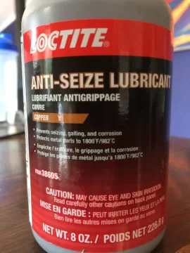

.............Even after sweeping it I still lift the black pipe off of the stove to vacuum all the debris that falls into the cat chamber and to lube the bypass mechanism so it slides like buttah.

does that have petroleum product in it? just curious
okay, thanks highbeam. where exactly do you put the lubricant on the bypass hinge?I’m sure it does. 99% anyway. The reason I’m not concerned is that this stuff is downstream of the cat. I’m less worried about petroleum and more about the metals. I put a lot of chainsaw bar oil into the firewood too.
