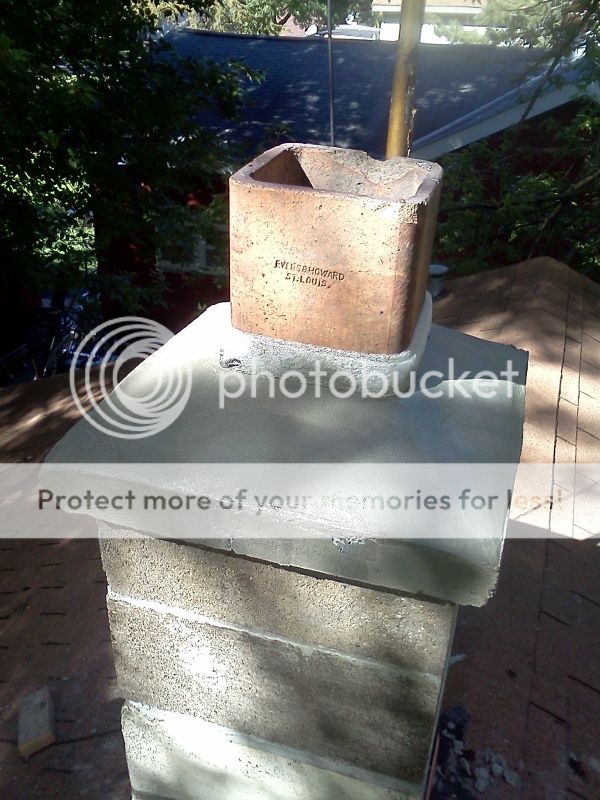

About 1000 square feet I suppose....its a small 2 bedroom witha basement and craw space under one North bedroom. Old construction, half the house is set on big rocks.
I have a furnace but choice to heat with wood, it just got easy with the BK.
The old stove, ugly yes but for $150 and a pick-up load of wood 15 years ago, it has paid for its many times over...and I added a water coil to heat my water heater for the last 5 years also during the winter.
[Hearth.com] 2014-2015 Blaze King Performance thread (Everything BK)#2
I even redid the chimney cap and extended it one more section this fall. Its in the middle of the house so once its warm it stays warm. At least they did that right when they built the house.
The BK with the small 6 inch flue, yes I know, but it worked and now its changed so everything is good.
