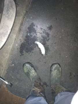

So I babysat this stove all day burned the smallest driest wood kept the door ajar a bit all day and this tiny cabin is 40 degrees and if you stand two feet from stove you cannot feel the heat yet it is boiling water in the tea kettle
Seems weird
This snow is 8" from the stove fifteen min have passed it has not melted I just took boiling water off stove 20 min ago
We pulled ash tray dumped what little was in it necked air tubes we could see and all seems well
When the stove came husband says they reassembled whole insides as nothing was in it so tubes are not blocked this was just last week
The back air flap hitched to thermostat stays open which is what we want
I read all sorts of reviews where people said this stove blasts them out
I want to throw this piece I crap in the lake
It is zero outside and 38 inside after stove went all day
