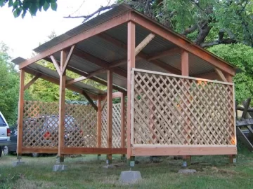

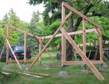

The lumber yard ran out of roofing, so this is as far as I could get this weekend, but it's almost there. I still need to put in the center partition. For this winter, the shed will also house the splitter and lawn tractor on one side. It's 8' x 16', 6' at the back and 8' at the front. If I stacked it to the gills, I could get 7 cords in there, but that prolly won't happen in my lifetime unless the wood fairy blesses us with lots of free wood.

Very nice job BG! The more I look at yours the more mine looks like a pile of tooth picks..I really like how you set your posts.
Thanks. I will say it's rock solid. Everything is bolted together and braced. The posts are on adjustable anchors which made if really easy to tweak the levels. My wife gave the seal of approval today, she likes the latticework.

8x16x1 is one cord, and since the roof slopes from 8' to 6' high, the average height is 7', so 7 cords.
(or, stacked 4' high, you've got four cords "on the ground", and then another 3 by filling it up to the roof)
You've got it Jay. Truth be told 5 cords will likely be the most it will ever see.
W-L, It's built out of doug-fir, though the lattice is cedar. The roof is corrugated, galvanized metal.

A quick question,
How windy does it get where it is located?
I see you have 2X6 roof rafters which is great, but do you think the metal roof will be anchored good enough?
I actually added some to mine because of the winds.
Good question about the roof. The answer is, I don't know. The shed faces north and has the garage sheltering it about 20 feet away. The back of the shed faces south. Our prevailing strong winter winds come from the southwest, but there is a large hillside behind the shed that usually shelters our property from the strong blasts, so I'm hoping it will be fine. But I could be wrong and it wouldn't be the first time.
I built the shed large enough so that I can be splitting wood out of the rain if need be. We'll see how it works out.

I have to say though, You don't have sheet for support for that roofing.
Me personally, I would have run horizontal lats (2"x4" size) every 12" across those rafters. Then faster the metal roofing to it.
With any type of good wind or snow load, those unsupported seams will sag & leak.

I'll compromise and will add them so that every 2 ft. is supported. Thanks for the tip!

But - if I were using that shed, the lattice work wouldn't last one season, befopre a chunk busted right thru during stackin or moving wood.
Mine is lined with plywood for toughness. The open end plus the gap under the eaves in the rear offers sufficient air circulation. ( although your design is optimum.
