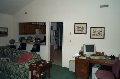

This is the room where I have my woodstove. It is a long room with a cathedral ceiling and maybe +300 sq. feet. I have a ceiling fan up there which does great for that room. The cathedral ceiling and walls really trap the heat just in this room and it is starting to get near tropical during my evening burns. The difference is like night and day when you walk through that doorway - like walking outside!
I can feel some cold air coming into the room at the lower part of the doorway and am sure some air is flowing out through the top of that kitchen window and the doorway. But it's as if no heat is really getting out there. I'd like to force more cold air into that room (which should force more heated air out of the room) but don't want to block the doorway with a floor fan. Plus, my floor fan is a beast and the noise/blast would be a nuisance. And my cats would hate a noisy fan and avoid that room, which I would like to avoid (and like the cats so don't go there!)
Anybody know of a quiet fan? I'm eyeballing these tower fans online but have never seen one in operation. They seem slim, stand up off the floor a bit, and might not impede travel in/out the room. I know they make those corner fans but my goal is to move the cold air in and so I need a fan near the floor.

Now you know why these big ceilings are usually heating disasters.
Question is..... is the ceiling in the kitchen through the doorway a cethedral also? If so, cut it out and make a nice triangular open window.
There is no pathway for the hot air to move in and displace the cold air to make it move toward the stove.
The fan will do nothing in your case.

No, the kitchen ceiling is not as high so a cutout will not work.
I do think cold air comes in at the base of the door and warm air flows out the top of the opening to the kitchen. I can feel the cold air flowing into the room, I'm just hoping to assist this process. I bought a small box fan, about 1/4 the size of a normal floor fan and placed it in the doorway. It moves a surprising amount of air, even on low where it is quiet. I'm thinking it will help a lot. I guess I just need to decide if I think the warm air flowing into the rest of my house will actually warm it up a noticable amount.
