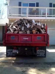

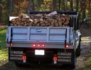

So I arranged to have some wood delivered later this week. I have bought from the guy before a couple years ago, got pretty nice wood, fair amount. This time he says he's delivering 1.5 cord loads in his F-350. Skeptical, I asked how he was getting that much in one load. He said its a 10-foot bed with high sides, nothing more specific. Do you believe it? If its 10 long, 5 wide, 4 high, that's 200 square loosely thrown. I'm not sure that gets to 1.5 cord stacked. Any thoughts would be helpful, since its not too late to call it off.
a 10ft bed? is it a flatbed?
yeah, what Lee said....
I was picturing the standard one-ton with an extra-long dump bed. Sounds like it could be extra wide too Lee?
i would be skeptical , dont let him dump it without looking many times you get this, and they call it 1.5 because the sides are a little higher...i believe they think they are giving you 10x6x4 =1.8 cords by the math .. however loosely thrown in wont equal 1.5 cords in most cases.... you will be lucky to get a "strong" cord

Just take a good look and measure the bed. My next door neighbor has a 350 with an aftermarket dump box and I think the sides are 3' and width is 6' making it a little short on holding 1.5 cords
That works out to a little over 2 1/2 tons. Is the F-350 rated for that?

Is it rated for it , Not sure and I would think it would depend on its options Duel rear that kinda deal . Can it handle that ,absolutely, I have had 5100 lbs on my F250
I'm pretty torn. I won't be there to measure the first load he dumps, but should be for the next 2. I was thinking of trying to stack the entire first load before he shows up the next day, but that may be unreasonable for me time-wise. Not sure I want to take the time to argue if it is off. Hmmmm.

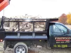

Well, despite the helpful advice that some of you have given indicating that in fact he could do 1.5 if he really filled it up nice, I canceled the order. Just so happens I found someone delivering for a couple bucks less and arranged to have him start hauling today. I just had my first cord dumped (out of 5) and there is no doubt its a full cord. He has a new Chevy 1 ton with what I would say is a standard dump body (8 ft?) with custom mesh sides that go up as high as the tarp behind the top of the cab. It was heaping over that point. In fact I just went out and met him as he brought load #2. He said his loads are 180ft thrown. I'll post some pictures over the weekend. I have my work cut out for me! Thanks for the help folks. My instinct just told me it wasn't too likely to be a true 1.5, so I had to go with my instinct - I always kick myself when I don't.
Probably a good call. One cord is a better expectation for a 1 ton.

Here's a pic of the delivery truck from his CL ad. Nice stuff!
