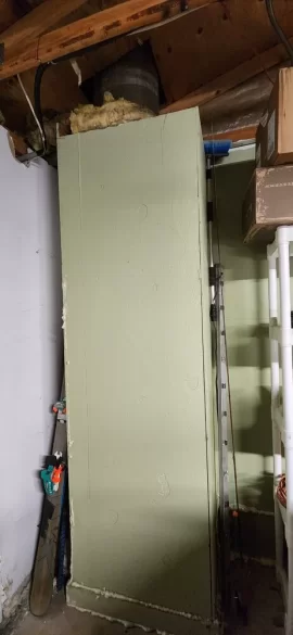

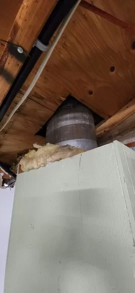

The chimney pipe enters into garage and then to roof from basement

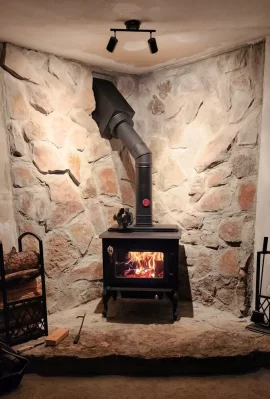

Well the project is done
Ended up getting rid of the earth stove upstairs found a jotul f3
Downstairs we bought a drolet 1800
I relined both existing older triple walls
Removed the chase in the garage it was useless. Thank you everyone who shared their knowledge. Much appreciated

That's a unique solution. How does the chimney connect on the other side of the support box?
A couple things to note with the Jotul install. The heat shield needs to be open on the top by at least an inch to be legal and effective. This is so that air can freely convect behind it to protect the wall. I like the idea of raising the stove but it needs a better base. The legs are too close to the edge for me to be comfortable with.
