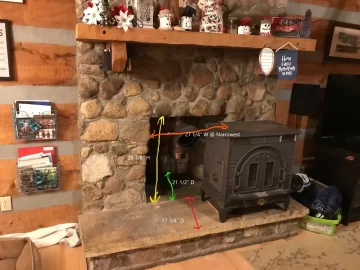

My wife and I have decided to get a Kuma Insert. We think that the ability to extend it onto the hearth and customizing a surround to fit inside our fireplace face are awesome features. Also, they appear to be the most efficient inserts available, as well as American made. I've had a fantastic experience conversing with Jason from Kuma.
So here's my issue. I can't decide which size to get. I've attached house layout sketches(rough sketches, sorry), as well as listed the information for comparison. We are in North Central Ohio. The winters can be mild, never dipping below 20 F, or we can have 2 weeks of single digits in a row (or more). Our central heating system is a heat pump. This year we were able to test it since our wood stove was out of commission. The heat pump did a great job maintaining 69 F. Though, on the sub 20 F days, the heating strips kicked on in the blower unit, affecting our electric bill significantly.
Most of my firewood hoard is cut between 14"-18". I get a good amount of free already-bucked wood, so the sizes vary. When I cut it, I aim for 16".
I've read so many things and I now have analysis paralysis. Jason recommends the Alpine for our space, which my wife agrees. Our goal is to heat 'most' of the house. I realize that on the first floor, the back bedroom and bathroom will not heat very well. They never did with out current stove. I'm going to try a fan next year down the hallway and see if that helps. Our house is 1600 sq ft. The area we intend to heat is ~1200 sq ft. However, as you can see from the layout and picture, we have a giant open living area. We do have a ceiling fan, and that helps keep the heat down stairs. With all that being said, the Alpine is probably the wiser choice as to not roast us out the majority of the heating season. However, our home is a log cabin, and for right now it is a little leaky on the first floor. I have some cracks that need addressing, as well as a rotted log. And I feel like the insulation between the logs is less than desirable. With that being said, would it be wiser to get the larger Cascade? I know we can always build smaller fires in it, and merely feed it more often, but with that information Jason still recommends the Alpine.
I guess I'm just grasping out there for more information to analyze and think over (likely a problem I have, I should probably get help for). We are 'probably' getting the Alpine. I just want to make sure that we don't make a mistake with our leaky house and should have gotten the larger insert. At some point I do plan on addressing the lack of air tightness of our house. Honestly, we don't even notice it unless its less than 20 F outside, and the wind is blowing.

You've already had my 2 cents, again go bigger! Its sounds like having more flexibility with your wood size may be important to you. Our Alpine will only take 14" splits N/S and 16" E/W. You'll be happy with either stove, The Kuma is an amazing stove!
After living a 1.7 cu ft firebox I vowed I would only get 2 cu ft or larger if I ever was given a choice in the future. There have been on several occasions that I was only able to reload a single split ( large and oddly shaped though). My fire box is sloped front to back and that may not be the case with the Kuma. That said I would not spend more than 600$ for the larger insert. 2.5 isn’t a huge stove either. More room for lower btu wood like pine/poplar that seasons faster.
Just my thoughts. If it has to stick out much further than the Alpine, more than 2”, I’d go alpine.

That's a good point. I don't mind it sticking out further though, more radiant heat :).

I hear ya, I'm just having trouble convincing the wife that the larger stove doesn't have to burn on high all the time.

Also, if you run without the blower on(or on low) it will put out much less heat. :)
Go for the Cascade. You can always build a smaller fire for milder days.

I think we both have had a poor experience with that old stove. I talked to Jason for a good half hour yesterday. He's pretty adamant that the Alpine will do the job. He was explaining that the Low end of the Cascade isn't very low, and it will create fairly high BTU's, even if burning low or with a small load. I don't get the science of it all, so I'm taking his word. He said the Alpine actually has a lower low and a higher high than the Cascade. He was saying its very difficult to achieve perfection when burning with wood. LOL. Probably the truest statement related to wood burning.
There is no perfection when burning wood. Perfection is an absolute and wood burning has too many variables to get there. Sounds like you've finally settled on an insert.
