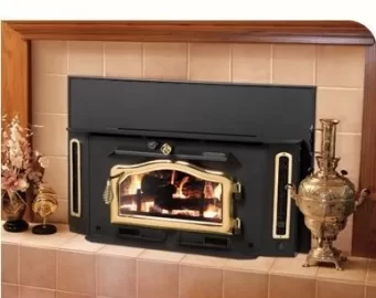

The Country Flame 02 is a very solidly built stove, and should retail for about $3000 with gold. It is approved for zero clearance fireplaces. I would agree that you should go with the liner.
Neo
  • [Hearth.com] ZC Fireplace Insert Confusion
